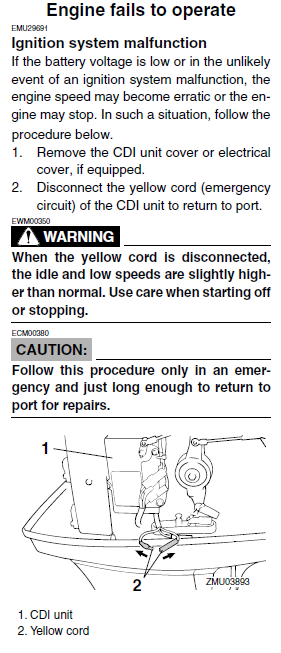

was researching why my 90hp ran one sunday just fine; and 36hrs later on tuesday morning if would not start. It will crank and fire for a second; but not run.
I found a post on here from 2012 that i don't believe was answered or resolved but i have the exact same issues. I have copied it here for reference. We have checked all coils; pulser coil; CPS; etc.
If we use the manual CDI bypass it cranks right up. I've also checked the key switch and harness and all seems to tone out fine.
We are running out of ideas.
