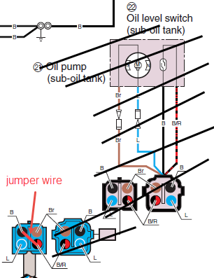

    I recently had a 2001 Yamaha 130 rebuilt and we decided to disconnect the oil injection. I would like to remove the remote oil tank from the boat, but in doing so my multi function gauge will read no oil. Is it possible to jump a wire to "trick" the gauge into reading full oil? The remote oil tank takes up quite a large area in my Hewes.

        look in your service manual at the wiring diagram, that should tell you what you need to know.

          If you remove the remote tank you will need to jumper the black wire to the black/red wire. In the connector that is on the main engine harness. This will turn on the green light on your tachometer and cause the yellow light not to be turned on.
