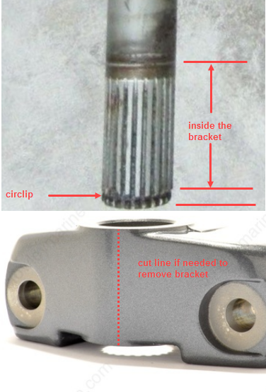

Well, I had to split the bracket to get it off. Turns out, boscoe, you were right again. It would have come off, if only it wasn't welded on by corrosion. It was all tore up from beating on it anyway. No penetrating oil ever made it down that far, it was seized up solid.
The grinding of the top weld was totally wrong. Dead end, fake news.
There was rust, and old grease caked up at the top of the tube, that's what was making it so hard to turn.
