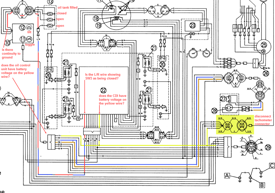

So does that mean that I should be able to test for after the manual switch to see if SW2 is closing by checking for continuity between black and brown? Just like I did before switch. I guess I was wondering if the something is getting lost going through the manual override switch box.

this is where I am.
key on , three flashing arrows on tach
I think that means remote tank full but engine tank empty. But remote tank is full so is engine tank.
I can drain engine tank. It drains all the way down until alarm sounds but does not transfer oil.
I can use manual switch and it fills engine tank, alarm stops when it should, and it continues to fill until full.
3 arrows still flashing on tach all of the time.

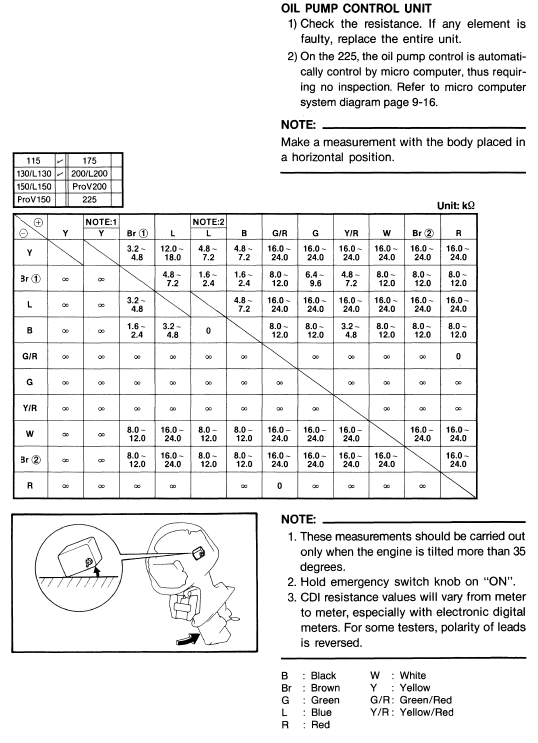

I tested engine tank senors switches for continuity. got continuity with all of them. SW1 (black/white), SW2 (black/brown), and SW3 (black/red)
I tested SWB for continuity and it was good. If SWB was bad would it even let me transfer oil with switch?
I have unwrapped all wires, inspected and tested.
cleaned all harness connections.
cleaned all bullet connects both male and female
Is there a single issue that can cause the arrows flashing and stop the transfer automatically? Or do you think that it is 2 separate issues?
