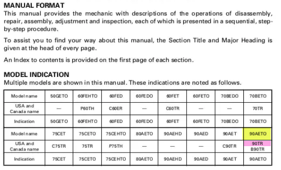

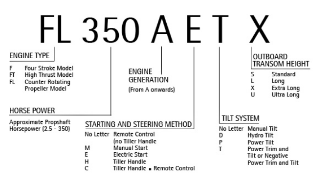

Hi All I Have a Yamaha 90 AETO 6 H1 L serial no 478870 and am looking for the year of manufacture. Have researched and there seams to be some conflicting inf on some charts have found one site that suggests the 6H1 series was made in 1983 and another suggests from the model as follows E = Enduro Series T=Power Trim & Tilt/Electric Start O = 1990 and L is the shaft length at 20" would AETO be the correct id cheers in advance.
Yamaha 90AETO
1991 model year. Could have been made in 1990 or 1991.
You may be confusing the model designation of a non US model with a US model. 90AETO is a model that was not distributed within the US. You won't find it in any Yamaha USA parts catalogs.
