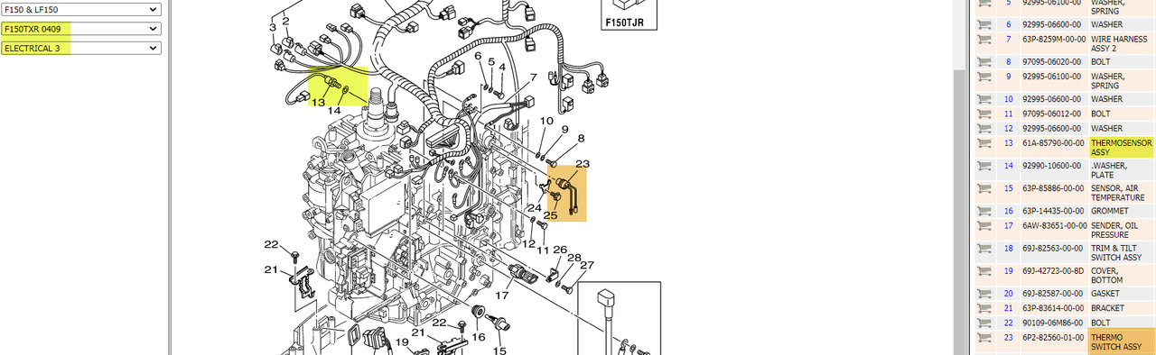

Seems some motors have more that one temp sensor, so locating them and shooting that area with an infrared gun when alarm sounds might give some idea if one spot is getting hotter than the other
The temperature indication shown on the Command Link gauge relates to the temperature of the block. As reported to the ECU by a thermosensor.Originally posted by Gulfstream232 View PostTrying to sort out an issue I’m having intermittently with both my outboards. I have 2009 twin 150 4 strokes. Routinely flushed after use and maintained through a certified Yamaha dealer by the previous owner (documented). Brought the boat up to Canada from the south at the beginning of the year, previous life as a salt boat, NC. Both motors under load will intermittently throw “overheating” on the command link gauges despite the temperature remaining dead center on the gauge. The alarm sounds, I drop off plane and restart the engine (no more alarm) engine is not hot and continue underway until the alarm sounds again (intermittently). Sometimes the port goes off and sometime the starboard, sometimes both and sometimes neither at all for multiple days on the water. I’ve changed the entire cooling system on both motors: water pumps, impellers, thermostats, thermosensors, POV valves and went to far as to remove the water jackets to confirm there is no salt deposit or anything else blocking the water from getting to the top of the heads as the engines will only throw the overheating alarm above 4000 rpm. I can ***** or idle all day on both motors no issue. Any guesses where else I can troubleshoot for gremlins? Almost seems electrical? I’m at a loss…..
There is also a thermoswitch that is installed within the cylinder head. That closes if and when the cylinder head gets too hot.
I would guess that the thermoswitch is closing while the the temperature of the block is just fine.
well, the temperature sensor - which is what the gauges show -
is set into the metal of the block -so "somewhat removed"
both in proximity, and response,
to the water in the water jackets.
The overheat notification is triggered by the thermoswitch,
which is set into the thermostat cover -
so it sees the water exiting the thermostat -
and should trip for "overheat" between 84-90°C
But none of that explains why the thermoswitch is closing,
if the cooling system is working properly -
and on both motors!
