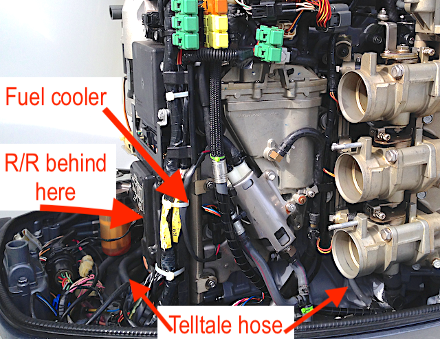

        further complicating things, on that engine,
        the telltale takes a circuitous route
        through a fuel cooler,
        and a chamber on the back of the regulator/rectifier.
        If those are packed with sand,
        there may be some chance of flushing/blowing them clear
        if not they will need to be 'excavated' and manually cleaned out
        bit of a PITA getting to them...

          Yep, definately a lot of stuff to move around to get to the regulator and fuel cooler. I can try though. Running the motor with the stats cover off is pretty impossible too because so many components have to be unplugged or move away for access.
          Can you safely run the motor with a hose connected to the muffs and the flush port at the same time? If so, hitting the telltale with air for a while is my next step.
