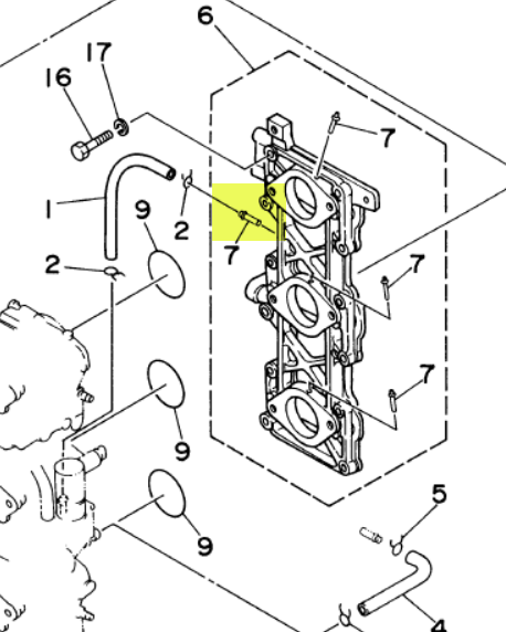

From what i gathered. They removed the oil injection parts. They replaced the case that has the oil injection ports. Then the prime start gave out and they rigged like this. But the engine wont turn on unless u prime the air vent with ethanol spray. If anyone knows, i was thinking of drilling the hole out, adding the brass pipe. Yamaha sells the pipe for 7 dollars.
So the hose the is highlighted is on my engine. As for the part catalog it dosent show it there but on the next part is shows isAttached Files
