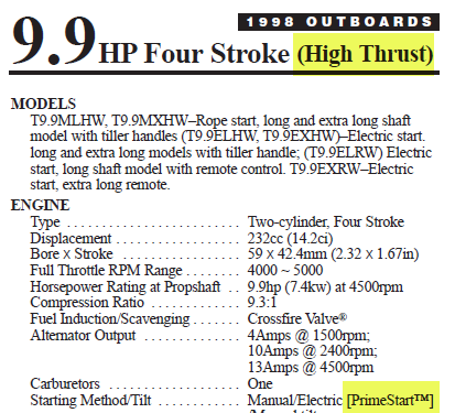

                      This the type of carb
