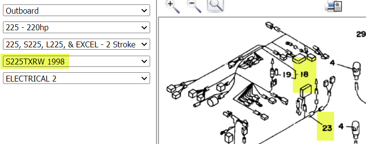

Hypothesis/Conclusions:
I think I may have some bad wires in the harness due to cowling not latching for a few years in the back and letting saltwater in.
*Dig through the wiring harness looking for corrosion and have to to tape it all back up after repairs or just buy a new harness and hope its in good shape?
$100 bucks for a used harness seen below to show affected areas.
After repairing the connections, there was very little left on the box doohickey(anyone know what that box is) that the corroded and repaired and corroded wires were on see picture:s-l16001.jpg
I read these as something to do with the trim, which I just replaced the PTT motor, but the wire looked pretty brown where the connections were corroded. I know I could do a bunch of testing on the wires to determine the bad wire but the new harness looks pretty plug and play compared to 3 hours of reading a meter and schematics. I think the reservoir oil pump wires lie in this harness somewhere too. The Black wire may have broke a ground which doesn't allow the VST pump to turn on which I believe is the not starting issue. It turns over great but doesn't get fuel.
Any input would be appreciated.
Thanks
Thanks
