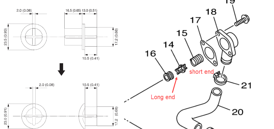

    1998 S115TLRW
    Boats.net lists the PCV part# as 6G5-12416-00-00 and the photo for this part# does not resemble the PCV pictured in the schematic #22 (schematic taken from boats.net)
    Simyamaha lists the PCV part# as 60H-12416-00-00 and the photo for this part# looks exactly the same as above noted part# (top photo)
    Found a PCV kit on simyam...688-12416-00-00KIT....and the PCV photo looks exactly as it looks in the schematic
    What gives here?

    6G5-12416-00-00 has been replaced by 60H-12416-00-00

      Gotcha....the outdated PCV was installed by one end going inside the grommet towards power head and the spring slides over the other end. For my clarity, this newer version PCV the mushroom end just rests over top of the grommet? Sound right?
          Somewhat confusing. In early illustrations for the new style valve Yamaha showed the button head resting on the grommet. In the illustrations for the last four two stroke models offered here in the USA, they show the button head resting on the spring. The cross section part being down in the grommet.
          One would think that a later change would be for a correction. But... My memory is too tired and worn to remember if Yamaha ever put out anything on this anomaly.
            I would think the smaller end would fit into the spring keeping it centered and the smooth button sealing against the grommet would work well,
            but then maybe the small end slides inside the grommet keeping it centered and does not move far enough away to come completely out of the grommet to cause it to get out of alignment.
            who really knows for sure.
            I have no idea how to get to the other end of the hose without taking more stuff apart, or if that would even help
              Upon further review, I am thinking that the later Yamaha data is the crap stuff.
              The short end of the X section for the older PCV goes into the spring. If one can believe the Yamaha parts catalog.
              If the X end of the updated PCV (same length as the short section of the older PCV) goes into the spring then the button head will rest on the grommet.
              God I love Yamaha data.

                            Per simyamaha:
                            Part # 60H-12416-00-00KIT
                            Superseded from Part # 6G5-12416-00-00
                            New style pressure valve. Replaces all previous. When installing, the mushroom-round end gets installed in towards the powerhead. The spring gets installed on the cross end of the valve.
