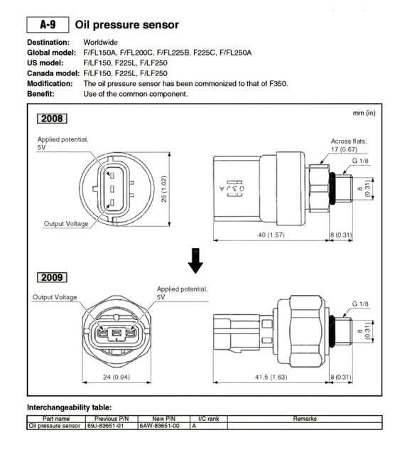

    I'm guessing you are dealing with the original sensor,
    where you can't see the steel base
    because its smaller than the bakelite electrical portion;
    if you hope you re-use it,
    you'll need an open-end wrench that's you've bent at a right angle,
    or you might find a "crow's foot" wrench that will work.
    If you are planning to replace it,
    then just snap off the black bakelite part
    and you can get right on what's left with a standard socket.
    In any case, its 17 mm.
    The replacement part is a very different design (and 24 mm)
      looks like the newer one has a different lookin connector.
      does the harness need to be modified when putting in the new pressure sensor
        Hmm, I never noticed that.
        But the new one takes the same connector -
        so if there is any difference in appearance of that particular section of the part,
        its irrelevant -
        and the artist might just as well as drawn it the same.
