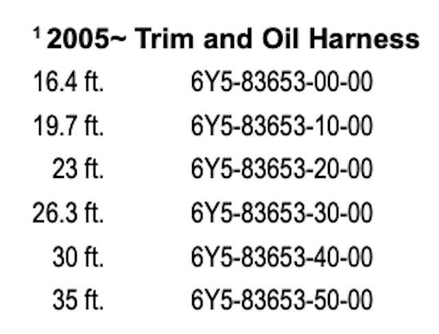

Hi, new member here. I have a 2018 F40 tiller motor and have bought a boat that uses a steering wheel and remote control. A friend of mine gave me a 703 remote and a tach they got at a garage sale. The remote connects and turns the engine over so that's great. As far as the Tach goes I am not sure how to make this work. I can't find anything on the Tach to identify the model number to find out how it wires up and if its compatible with my engine. I would appreciate any help. Here is a picture of the tach and wiring

Other questions now, the tach has a single pigtail and connector coming out of it seperate from the wires that go to the 703.
They are Pink, green with a red stripe green with a white stripe and a gray stripe. it goes into a connector and comes out the other side pink, gray, green with a red stripe and green. It was cut off just after that (see picture). I have the cable and can splice it back on no problem but what does this connect to on the motor? What's it for? How do I know if it will connect to my engine?Attached Files
Originally posted by kevinmcghee View PostOther questions now, the tach has a single pigtail and connector coming out of it separate from the wires that go to the 703.
In the front of the engine pan, coming out of the main wire harness,
is a single white-ish connector with 4 pink-ish wires -
that is for the tach.
Since the tach also has a single 4-wire plug,
you'll need one of these - a "Trim Oil Harness"
to go between the engine and the tach:
