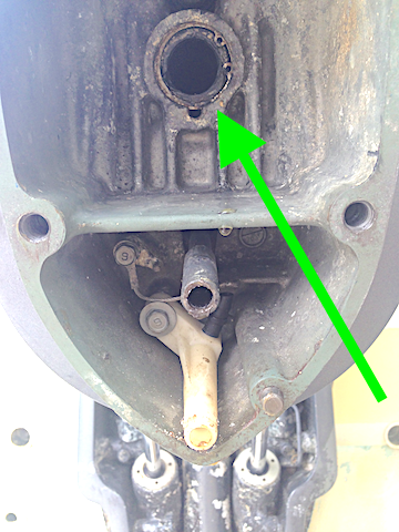

Plus 1 ^^^^.Originally posted by 99yam40 View Postmost common squeak on those is the driveshaft bushing needing to be greased
You MUST use the Yamaha waterproof grease or similar. Regular grease won't last a month and start squeaking.
My '06 F150, when dry, would squeak about 1700 RPMs and sound like birds chirping in the distance..
