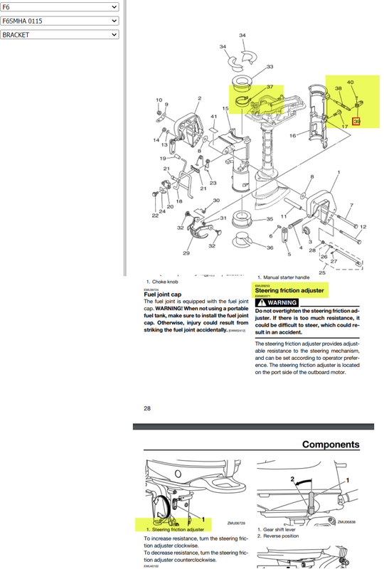

    model # helps others know what motor you are taking about.
    my guess is this link and part number 37, 38, 39, and 40 are the parts you speak of.
    Yamaha Outboard Parts by Year 2006 And Later OEM Parts Diagram for BRACKET | Boats.net

      Thanks for your reply and the link.
      My model number is F6CMH.
      Really helpful to see the parts. My guess is that the screw end is not finding the hole in the collar thing (37).
      I’m not sure if I dare open it up myself!
      Is it easy to open this part of the casing (I’d say I’m semi competent). My worry is that a load of parts will ping out and I’ll never get them back!

        Thinking about this some, I would take that screw back out and look into the hole to see if I could see any threads in there.
        I do not see how taking it apart would help since it looks like that screw has to be put in after it is together
        Just looked at #38 and it looks like the threads are not in the #37 area, probably in the #16 bracket
        Yamaha 6L5-42529-01-00 - SCREW, FRICTION PIECE | Boats.net

              I’ve just had a go at fixing it myself. Unfortunately I’ve not been able to get the pin (38) into the hole in the friction plate (37). It’s probably something a mechanic could do in a couple of seconds so I may get someone who knows what they are doing to sort it as I can’t seem to get it working!
