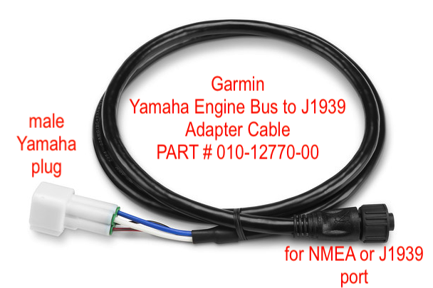

Garmin sells a cable with one end that plugs into the back of the MFD
(the NMEA 2000 port of the 741, either the NMEA 2000 or the J1939 of the 943)
and the other end is a Yamaha plug;
"Yamaha Engine Bus to J1939 Adapter Cable PART NUMBER 010-12770-00"
https://buy.garmin.com/en-US/US/p/616441
So you get 2 - one for each.

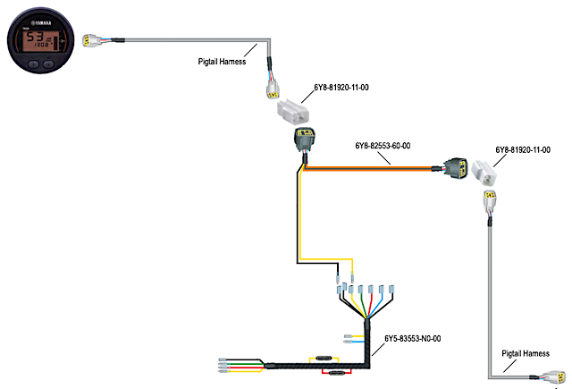

Now if you already have two Yamaha Command Link tachs,
connected without a multi-hub,
then your wiring is like this,
and you need to swap out the inline hub for a multi-hub:

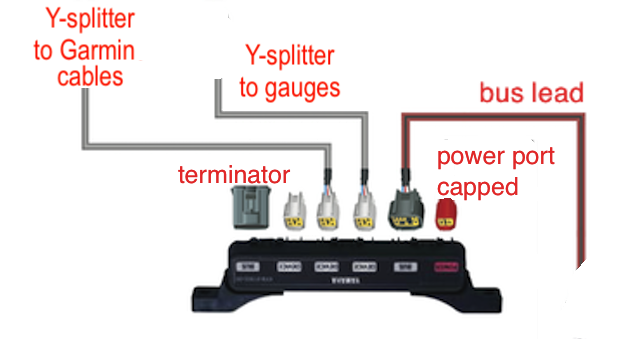

Now the multi-hub will have 3 "Device Port" spots -
one of which you will use for the existing Y-splitter cable to the gauges.
But you can't connect the Garmin cable directly to the multi-hub,
because (stupidly, IMHO) the Yamaha plug is MALE
and the Device Port is MALE
so you need a cable with female Yamaha plugs,
on both ends,
to go between each Garmin cable and the hub.

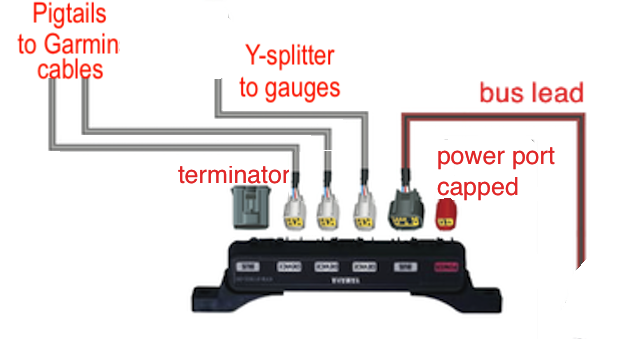

That can be EITHER
one more Y-splitter cable:
OR

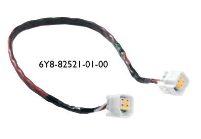

using two "pigtail" cables:

My current set up doesn't have a y splitter. Each engine to gauge is hooked up individually. The connector with the orange wire from the engine and the power wires to the 703 control is hooked up to another cable that goes directly into the multifunction gauge. I think this is the kit that is used for each engine and gauge.
Originally posted by Skin diver View PostMy current set up doesn't have a y splitter. Each engine to gauge is hooked up individually.
So you have this arrangement - TWICE -
separately for each engine/tach:
While there's nothing wrong with that in your original situation,
its not how it would usually be done,
you "used more wires than you needed".
Now, to have data from both engines on a Garmin,
you'll need to buy TWO multi-hubs
and the 6Y8-82521-80-00 Y-splitter cable.
But you'll have all 4 inline hubs,
and two wire harnesses,
"left over"
that you can sell on eBay.
This is what you need to do:

1 yamaha pigtail 6y8-8251-01-00 ( to connect yamaha engine bus to j1939 cable to multi hub)
