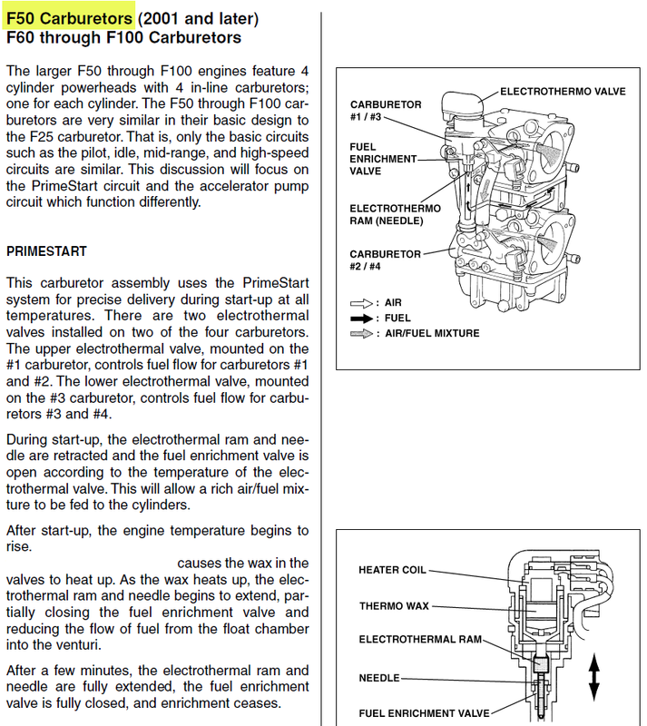

Just too confirm...4 carbs right?
It has not one...but TWO "prime start" electro thermal valves on it. One on the top carb and one on #3??
Any way you can see them there easy enough, two wires going to each of them. Remove the valve assy and hook it up directly to a 12volt battery, the pin (or needle) should extend after a couple of minutes. That's the choke system.

the power comes from the lighting coil while the motor is running.
it heats up and closes off the extra fuel as the motor warms up.
if the passages are plugged up or if the needles do not retract to allow fuel to flow when cold there will not be any enrichment

This is from one of my past posts when I was getting my carbs sorted out on my 99 F50TRLX
The prime start gets its voltage when the ignition is turned on.
The prime start works like a timed plunger or solenoid. When power is dropped, when the engine is shut off, the carbs slowly becomes choked as the prime start cools down. When you start the choked engine, the prime start slowly releases the choke and within a minute or so the choke butter flies are wide open. Turn the engine off and the prime start slowly chokes the carbs again. The temperature of the engine has no affect, although once the prime start warms up, the cycle is a little faster. Kind of a wacky setup.. You would think the unnecessary choking of an already warm engine would fowl the plugs, but it is not the case.
The choke solenoid gets it's voltage from the ignition switch and the thermal switch.
How the choke solenoid works..It will only activate the choke under two conditions.. 1: Engine must be cool enough for thermal switch to be closed..2: Prime start must have the choke released. These 2 conditions are almost impossible to exist at the same time. By the time the prime starter has released the choke, the engine is warm enough to disable switch two, disabling the choke solenoid. In turn by the time the engine has cooled down long enough for switch 2 to be closed, the prime start has already cooled down long enough to close the choke. Apparently the designer of this system wanted to ensure that this engine is choked when started, no matter what, whether the engine is hot or cold. Looks like the solenoid choke would never be used in South Florida, but this system may be useful is freezing weather.Last edited by ChuckB1954; 02-01-2021, 04:53 PM.

:https://www.boats.net/catalog/yamaha...lra/carburetor
Not sure what you mean are they in the normal Position. I pulled the carbs off and pulled out the enrichment valves. When I apply power it takes a few seconds maybe 30 they close so I guess when they are cold they are in the correct position.Originally posted by robert graham View PostAre the Primestart levers in the normal position?
If they did not close i would suggest that the enrichment or choking procedure would not stop causing the engine to run rich this does not seem to be the case.
So what I am understanding here is when the engine is cold fuel is allowed to travel in the Passage where the enrichment needle is allowing more fuel. when the motor warms it closes stopping the extra fuel. So really the only thing that could stop this is if something is plugging both enrichment jets very confusing what ever happened to just having a manual butterfly.. LOL
Like I said the motor when warm starts right up in 1 sec. When cold like over night or when down to Freezing temps it take 20 turns of the key or more to get it to fire then it quits then starts and quits this goes on for about 10 more times till I can get it to sit and idle. Once warm it runs great.. Thanks for all the input ..

Ok well My valve or needles are fully extended as they sit in the carb . When i apply 12 volts then then retract. seems like they are backwards. I measure the wires going to the enrichment vales and i have no 12 volts coming from the motor. Where does this 12 volts come from? This is maybe where the problem is. It takes about 10 seconds for them to retract pulling them off their seat which would mean if I am understanding this correctly enrichment will happen then as the motor warms up the valves are then extended and close the enrichment as the wax expands. I may just resort to putting a manual primer in it really does not have to be that cold out. It happens overnight in most cases. If the motor is running once then it starts fine for the day..
