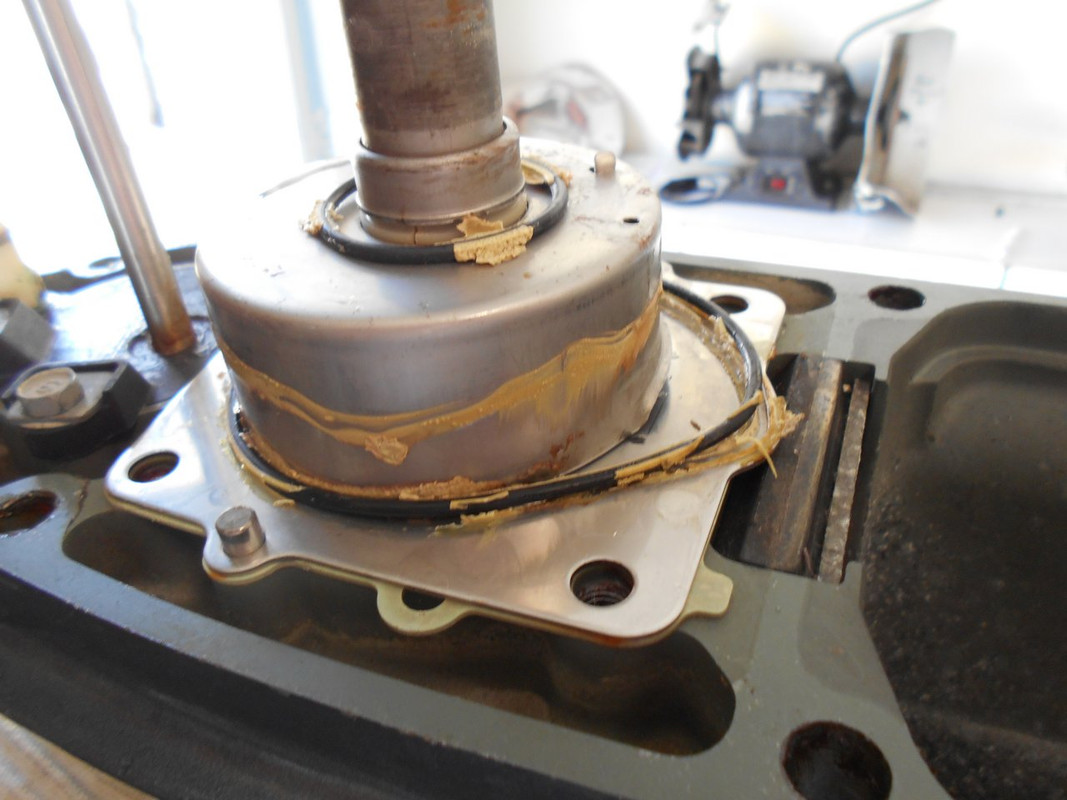

              To hold the rubber seals on the pump housing in place, I'll use just a smidge of Yamaha's water proof grease on the SEAL itself. That alone will hold that seal in place.
              And use either genuine Yamaha WATERPROOF MARINE grease for splines, (or equivalent) as well where the mid section /shaft bushing rub together.
              Regular marine grease will NOT hold up and it'll be squeaking in a short period of time
              Attached pic's are from when a MT used sealer on my pump.. (a frigging mess which took me quite awhile to remove all that crap)
              An 06 F150 as well:
