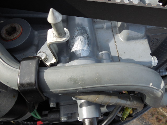

    yesterday, while running I noticed water pouring out from my engine callen. I expected to find a loose hose or something simple, but what I found was a 1/4 inch by 1/2 inch hole in the top of the block pumping saltwater everywhere. I plugged the hole with a piece of rubber off a boat plug and ran home 40 miles. The plug held with only a small seep and did not get worse on the ride home. This is obviously corrosion from lack of flushing. My question is can this be repaired from the outside with a jb weld type of product,along with a cooling system flush. This is a great motor, everything works fine, but its not worth replacing a block. I will post pics of hole if I can figure out how
    Also engine did not overheat. It was still peeing when i caught it

        Not unheard of,
        "salt"- aluminum corrosion product-
        accumulates behind the thermostat,
        stays wet,
        and the corrosion continues even when the engine is not being run.
        Certainly it can be welded -
        if you have someone capable, interested, and affordable,
        to take the trouble to 'do it right'.
        "JB Weld" can also 'work' -
        but success depends on the execution.
        Like any 'cancer' it has to be thoroughly removed -
        cleaned down to good, bare metal.
          I have a hole welded up also
          the guy had a problem with the metal impurities gasing off and blowing holes in the weld puddle, but finally got it done.
          the deep pits on the inside I used JB weld to fill in.
          But the hole was close to the shoulder the stat fit in.
          I sanded and filed it down smooth before putting it all back together.

                First, I hope you washed that motor down with soap water and sprayed it down with WD40 or similar. Can you insert a sleeve in the housing to take care of any pressure on the repair than JP Weld the outside for a finale seal?
                  The "correct" way to repair would be to weld it as noted above. I would trim away the thin aluminum and make a "plug" to fit in the hole (as the hole will get bigger when cleaned).
                  JB weld would probably work but certainly not as dependable (especially as the hole gets larger) as a weld-Especially if running way off shore, IMO
                  With the plug, it'll be much easier to weld.
                  *I did a similar repair on a head on a Mercury which rotted away allowing the water jacket access to the combustion chamber. Worked great and that was sealing the combustion chamber, much higher PSI than a water jacket
                    Any sort of glue/epoxy is a temporary patch, weld or replace is a permanent repair.
