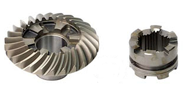

maybe, but probably not.Originally posted by TONYG279 View Postis the shit lever suppose to move forward or backwards if the engine is off?
'shifting into gear' either the forward or reverse
involves sliding a toothed 'dog clutch'
which has to "mesh" into 'cavities" on the gear
when the motor is not running, the gears are stationary
and unless - by random chance -
the cavity in the gear happens to line up with the tooth on the dog clutch -
they cannot mesh
and you won't be able to move the shift lever
with the engine off,
if someone else rotates the propeller
then the dog clutch turns
and eventually will line up to allow shifting
this is a typical outboard gear (forward or reverse) and dog clutch.
You can see the projections on the dog and the recesses areas of the gear.
They have to "line up" to engage.
Them not lining up, is the grinding/clicking noise you hear as you shift
which is why you should shift quickly - get it over with
