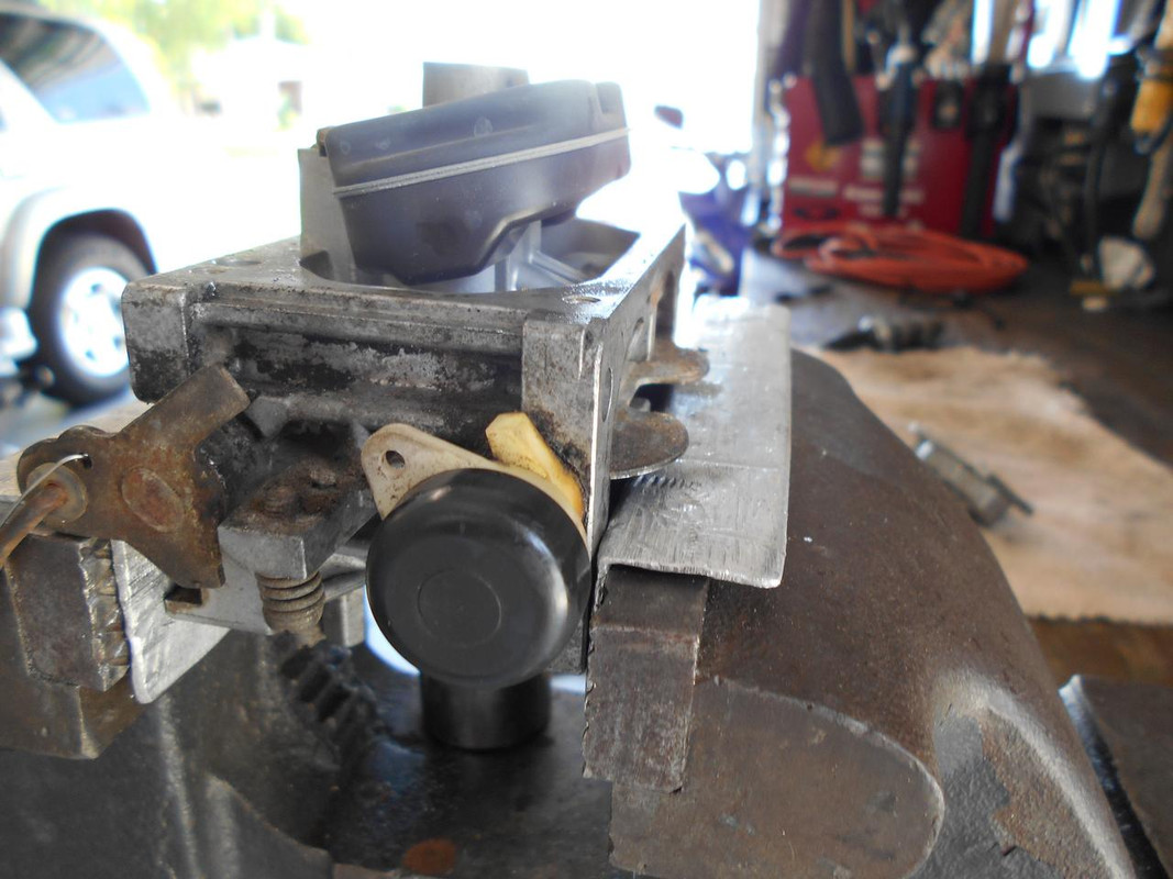

Thanks for all the help guys I really appreciate it. I figured before I go any further I better tear the carbs down and clean them. I only got to one last night. Everything seemed clean. Only thing I could find that didn’t seem right was one of my floats was sitting lower then the other one. I know the float has a tab I bend to adjust it but which tab is it? There’s one that holds the valve needle and one that sits behind the needle valve housing. I tried both of them with no luck lastnight
Holding the carb UPSIDE DOWN so the float (when seated on float pin) should be about level.
There is an adjustment on the "backside" of the float to adjust "drop" (carb in normal position), float shouldn't drop much farther than with the bowl installed.
There is a set # to measure from the carb body to the float (don't know what it is for your model), but pretty much should be level, NOT pointing / angling towards the carb body...
This carb (upside down), the float is way too high, resting against the needle. It SHOULD BE level.
Now IF this carb upside, that drop would be about right..
