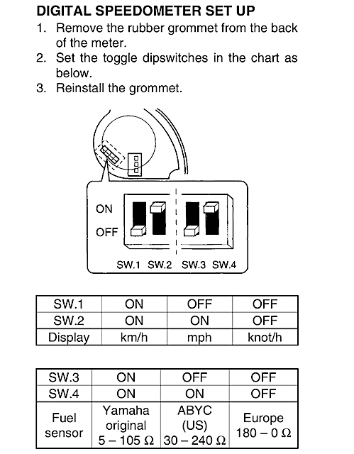

Good afternoon Yamaha Forum, first time on line. I have two F60CET outboards on the Whaler and have installed new fuel tanks including Yamaha fuel senders, on the gauge I have a white wire that I was told was the one wire to connect from the gauge to the sender, question, where does the other wire go from the sender?
Multifunction 6Y5 Gauge
Thank you Fairdeal, by the chart you sent me, and the resistance of the fuel sensor the Yamaha dealer supplied me with is a ABYC 30 - 240 ohm, will check the both gauges tomorrow, I have two F60CET outboards with two sets of gauges and two fuel tanks, one each side, thank you again.
Thank again Fairdeal and Boscoe99, you have given me the information to get both these fuel tanks operational, have a great day.
