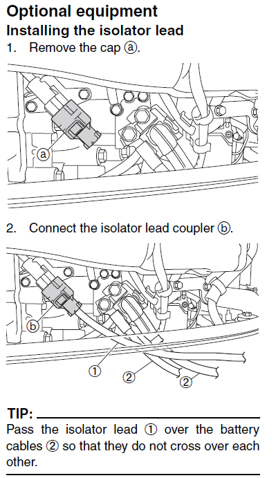

Can someone advise where under the hood I can locate the auxilary charging lead?
I have 2021 F300's
I understand it is a single red wire with a black cap on it. Just need to know where to look for it.
Thank you!
