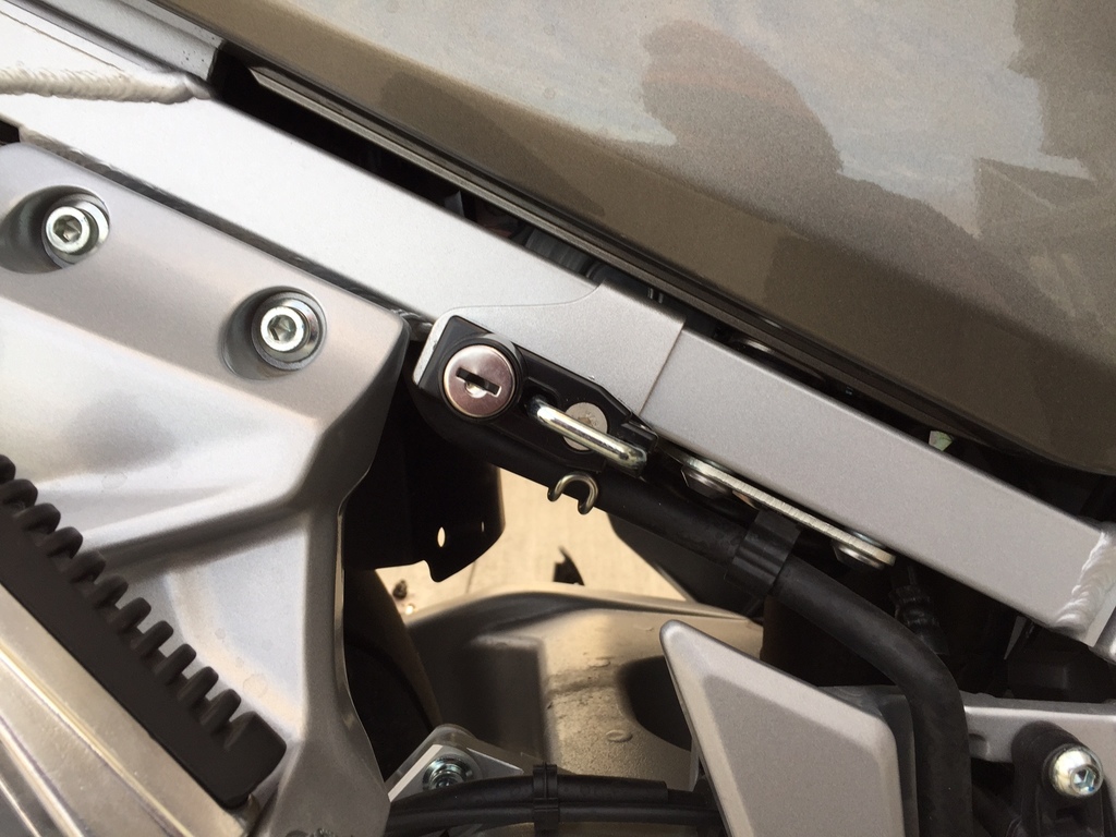

                    BTW, I've been designing and making Helmet lock brackets for ALL year FJR's since 2004 (the year I had).
                    If you follow any FJR forums, or do a simple search, their all over the internet (as I'm the only one making them specifically for the FJR((and other bikes)).
                    IE:
                    One of 6 options.
