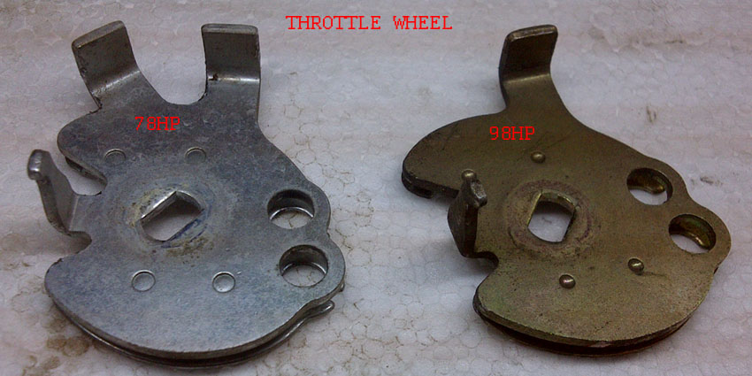

    Not in the US, but Europe, etc, there are HP restrictions on the same motorcycle engine (My Yamaha FZ6, 600cc-about 98HP, FI'ed).
    The same engine, uses a different THROTTLE STOP on the throttle/butterfly shaft to STOP full opening and reduces HP to 78hp

              My beginners XSR700 they did just that, and after market suppliers made a replacement plate to allow full opening. Interesting that the original on your example still provided that stop and they added one in front of it, as if you could remove the restricted stop without particular attention to precision.🤔
              So in reality the premature stop equates to a smaller carby or throttle body without having to design and supply a different one. Of course the word throttle explains what is happening; we keep opening the throttle to increase power. By putting a larger carby or throttle body we are just opening that throttle further.
