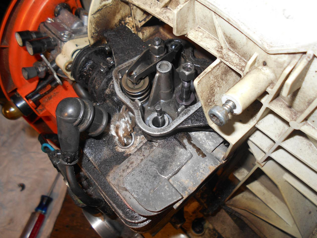

    Get to the valve cover and find the valve guide PUSHED OUT of the head, apparently by the valve. The valve retainer FAILED(about 1/3 separated but everything still under the valve cover. Fish the valve back up into the head. Do a leak down test both at TDC (valves closed) and at BDC (checking for potential damage at the lower end of the stroke).

        The broke spring retainer:
        Close up under the valve cover:

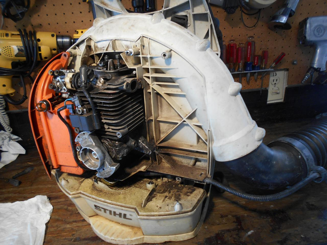

        Overall machine partially apart:

            He's super cheap, the machines run hard (as you can see) and to cut the seat, the case splits at the crankshaft (so you have to reach down thru the cylinder to get to the "head").
            Stihl is way worse than Yamaha, everythings buried beneath something else.

                Yep, that's exactly what happened... The valve pushed the guide out of the head. The guide was loose under the valve cover. The head of the valve, fit into the now, larger hole (stem had lots of room now) and locked up the piston from rotating (not enough clearance).
                I did try re-installing the guide and did get it started (it did NOT drop in easily) and needed hammering, however, the valve was stuck in the guide (think the guide ID got damaged) and I had to pull it back out (with heat) and the guide cracked apart once vise grips got on it.
                As posted earlier, I went thru the exhaust port (like a 4 stroke), saw a little of an "edge" and was able to sneak a thin strip of sandpaper(forgot the name, it's re-enforced), thru there and clean up the questionable edge. What's left of the old guide NOW slides over that area and doesn't hang up..
