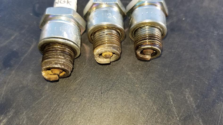

          It's been 4days since I last started her. Today she fired up no issues. I did spray corrosion stop into each cylinder and changed the plugs. These are the old plugs

              Yes those three plugs are different from each other. The left looks a bit sus, but I worry more about the middle one, it seems too dry and clean. Clean could mean water is getting in. Rod bolt has claimed he can read plugs very well.

                  Those plugs are still new, maybe 10hrs or less. Left plug is top cyl, right plug bottom. More thorough troubleshooting today

                    well we can post up a bigger pic of the plugs and hope Rodbolt will drop in and give his expert opinion on what these 10 hour run plugs tell him.
