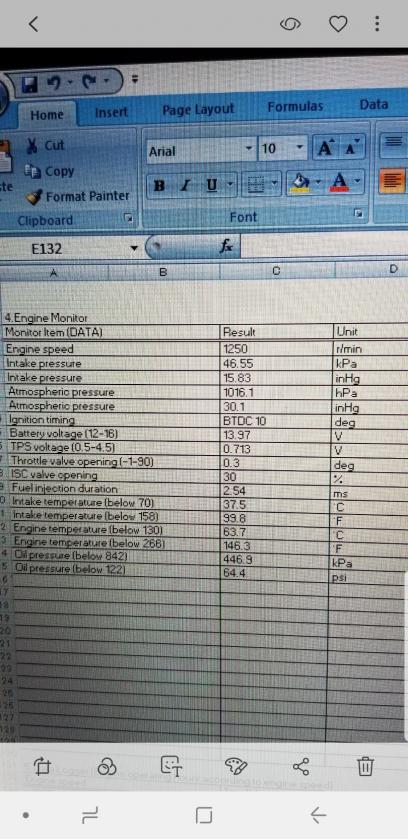

    I bought a used 2006 F150 TLR and has a high idle. I don't have much previous info on engine other than hours of 107. I have been trying to diagnose a high idle issue. It idles around 1200 rpm or so. I have bought the YDS software and have no codes. Here is a few things I have checked. IAC valve clicks and rattles on shut off. Pulled out and ran test and it moved up and down like I think it should. Pulled air intake silencer and verified the throttle body is fully closed. Checked all electrical connections and what not. Issue still persist. I have ran the active test on the IAC valve and it seems to test correctly. The TPS voltage at idle is .7 There is a few values that throw me off. The timing is around 8-10 degrees and the IAC valve says it is at 30%.

              posting a screen shot of the YDS read out at idle might let Rodbolt or someone give you some input on what all is out of wack

                      thought I would try to make it easier to read
                      that did not work as well as I thought it would, I tried to enlarge it more., but it dropped back down when i posted it.
                      also I see in the second pic that the shift switch is ON, not sure if it means it is in gear or neutral.
                      someone will know
                      Scott, you see anything different on his read out than yours
